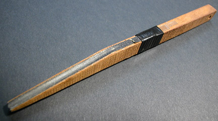

Take a leftover piece of fretboard 1/4" sqare by 7" or so and carve a channel into it in the curved shape of a crowned fret. glue a strip of 320 or so paper inside the channel only and Walla!, you got a crowning tool.
works for me.

Sometimes my words can’t describe the intended object as well as an image.
I should have known. Sorry for such a bad description guys.
http://www.wadefx.com/crowntool.jpg
The idea for this tool is to install the abrasive to the inside of the channel, leaving the outer edge wood. That way you will only shape the fret and not your fingerboard.

PostPosted: Wed Dec 21, 2005 9:44 am
Thats a neat tool you made there Wade. I also like the Stew-Mac offset diamond file for crowning.
PostPosted: Wed Dec 21, 2005 9:36 pm
Wade, with that little tool you have officially entered the pantheon of Luthiery heroes. Guess what my job is tonight.

Hi Colin,
Thanks for getting that pic posted.
(Officially entered the pantheon of Luthiery heroes) I am deeply honored.
If you look close you can see I used double sticky tape to hold the paper in place. The curve continues on the other side as well. It’s not as slick as the Gurian or the Diamond systems I know but I like to make tools when possible.

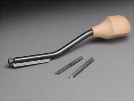

PostPosted: Thu Dec 22, 2005 8:11 am
This is the stew mac one...
I love it!
